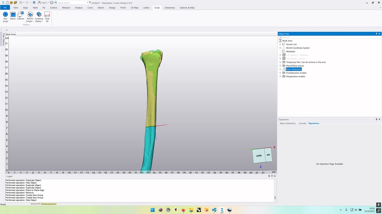

I have a Python script for performing osteotomies, which includes my own custom GUI.
At one point in the workflow, I need to select the osteotomy plane in 3-matic, translate it manually, and then click Compute.
However, while the script is running, 3-matic does not allow me to interact with the model (e.g., selecting or moving the plane).

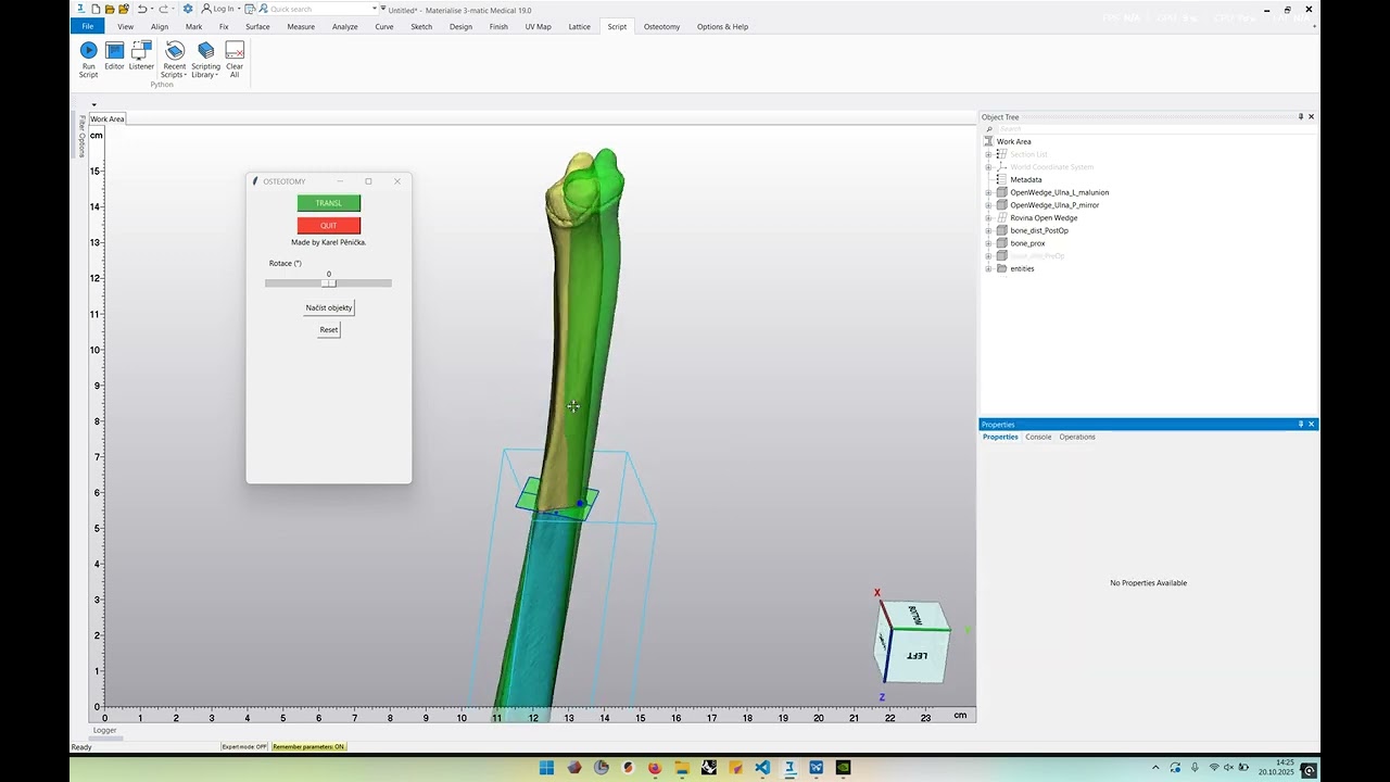

I use it in this script. It was recorded before i rewrite code with your advice.
Thank you again.
